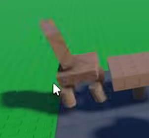

How can I make this effect?
Hi! I’m working on a game that involves a building system. It’s kinda boring rn. I saw this devlog of a tycoon and he made this breaking effect. It’s where when an item is destroyed pieces fly out and at the end they get smaller and fade. I have looked it up and can’t find anything on it. I have linked the timestamp to the video here.
How could achieve this?
I assume this just positions a bunch of unanchored parts at the same spot with cancollide off, then throw them into a random direction and using .Touched you can tween the size.
Idk about the performance though, if you want better performance you would need to do complicated math.

later on in the video you can see that the effect is made more simply (though I would love to plug my voxel destruction library here)
The creator just unanchors/unwelds every part and gives them random impulses. At the same time, they have their size tweened smaller (as you explained). It’s a neat effect!

Thought this would be be a fun challenge so I tried it.
First, I got the bounding box of the model and calculate both corners. Then I used the solution from this post to position each debris part within the model. From there, I launch each part up and in a random direction using the assembly properties before tweening it’s size and transparency out.
In this effect, the positioning of the parts and their movement can be approached differently. In the video, it looked like the parts were more organized, next to each other almost forming a cube with the cubes, then each one was fired outwards. Both of which I could not figure out how to do.
