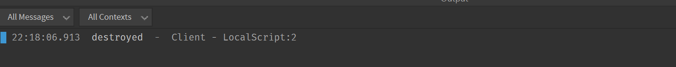

He wants the client to know that the object is being destroyed so that he can clean up some connections beforehand. In that case .Destroying absolutely works through boundary.
I have issues with Destroying or AncestryChanged due to deferred behaviour. When this events are run, the object is already destroyed which could be problematic. short exemple to demonstrate the issue

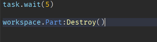

Server
local testModel = workspace.testModel
local RemoteEvent = testModel.RemoteEvent
task.wait(10)
for i = 1,10 do
task.wait()
RemoteEvent:FireAllClients(i)
end
testModel:Destroy()

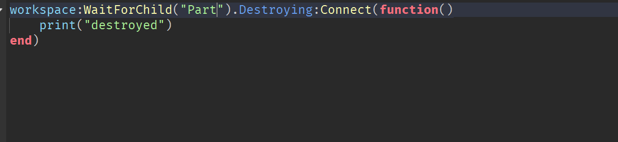

client
local RunService = game:GetService("RunService")
local testModel = workspace:WaitForChild("testModel")
connection = RemoteEvent.OnClientEvent:Connect(function(i)
print(i, RemoteEvent.Parent)
end)
testModel.Destroying:Connect(function()
connection:Disconnect()
end)
